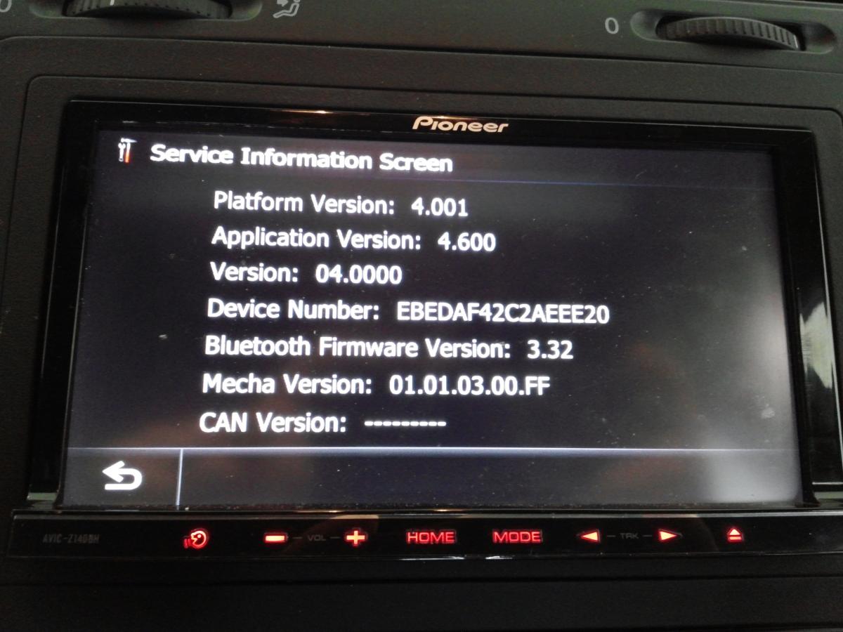

yea no luck. tried doing it with just the map update files and cardinfo file on the root of the sd card and my HU sees the sdcard but doesnt start the upgrade...ive attached a photo with my service info. Ill give a nice donation on friday to whoever can help me get this figured out. My email is cdt82002@gmail.com. Phone # is 678-577-3706.My name is Chris.

First off, thank you very much misterwoofwoof. I sent a small donation, it won't cover the money and effort spent by you, but I hope it helps.
Second, for those having issues. Format the sdcard before placing the map files on it. There may be some hidden files causing a conflict.
I also recommend using 7-zip to uncompress the files.
