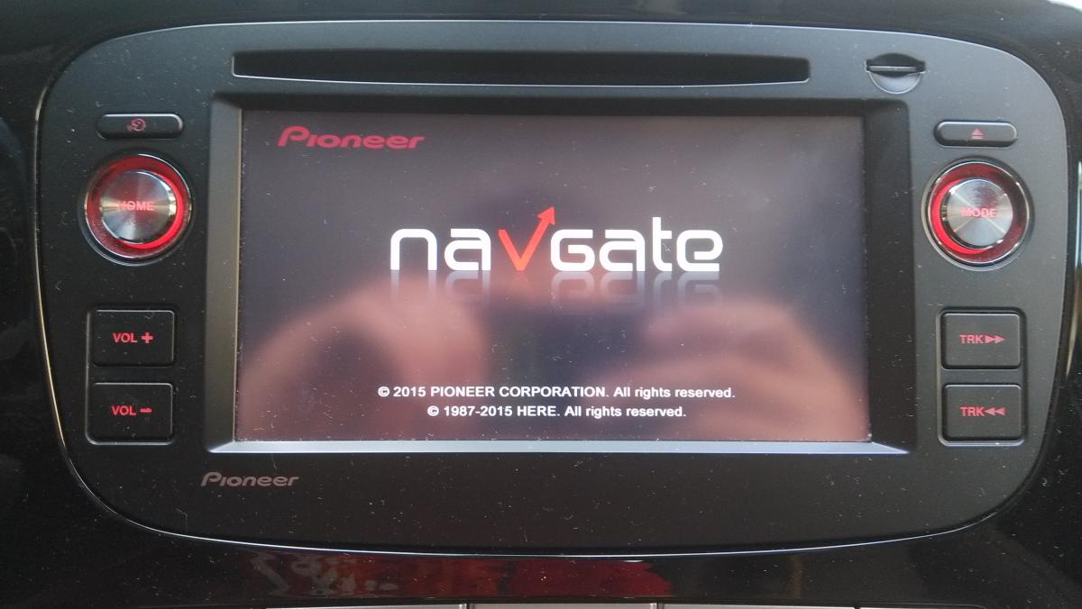

UPDATE MAP 2015 TESTED ON F9220BT
download here: https://mega.nz/#F!B...XSpv5FGHo_V0pA
2015_European_Map_Updat (2.95GB)
"cardinfo.cif"
"verinfo.dat"
unpack it with password: http://pastebin.com/y2cCdzrE
Now go in folder 2015_European_Map...../.../SD drive/
and put there CARDINFO.CIF file and replace old one
next go on ..../../SD drive/UPDATE folder
and put there VERINFO.DAT file and replace old one
UPDATE ARE READY FOR PUT IN SD CARD!!!!!!!!! (This are way for AVIC-F9220BT only!!!)
Now FORMAT ur SD CARD: FAT32 and 16kB!!!
after Format SD put there all from SD drive FOLDER.
Now ready for update ur PIONEER AVIC:
put SD CARD in RADIO and turn ur RADIO ON, after starting RADIO give u question if u will UPDATE SYSTEM(press OK)
Now Question SYSTEM WILL BE RESTARTED(press OK)
after RESTART will u see updating and 30min till end, and after 1min will be 22min. When will be 100% it will restart system and continue with 6/6 small updates system files.
And if all completed, AVIC do restart and wellcome u new version of ur system and maps. Now u volte ur languange and voice language.
THAT ARE ALL AND U NOW HAVE 2015 MAPS!!!

Instructions to update AVIC-F10/F20/F920/F9210/F9220BT (working links as of now)
  1. Download file: 2015_European_Map_Updat_for_Pioneer.zip from here (3 GB download including all Europe latest maps).
  2. ZIP is password protected. Extract the contents with the password seen here
  3. Move all files to the root of a freshly formatted SD card (4 GB or larger required)
  4. Replace CARDINFO.CIF with this version
  5. Replace UPDATE\VERINFO.DAT with this version
  6. Insert SD Card in your Pioneer, follow instructions (~30 minutes with progress bar - DO NOT INTERRUPT OR POWER OFF)
  7. After reboot go to Bluetooth settings and update bluetooth firmware separately (~5 minutes with no progress bar, just wait until finished - DO NOT INTERRUPT OR POWER OFF)
  8. Confirm update by looking at software version (6.0000) & Bluetooth firmware version (3.32).
  9. Remove SD card, go for a test drive and check everything is OK including fresh maps, latest points of interest and text-to-speech (TTS)
  10. Add additional TTS (text-to-speech support) only if your language does not already exist. Use these files: CZC (Czech), DAD (Danish),  DUB (Flemish),  DUN (Dutch),  ENG (UK English),  FIF (Finnish),  FRF (French),  GED (German),  GRG (Greek),  HUH (Hungarian),  ITI (Italian),  NON (Norwegian),  PLP (Polish),  PTP (Portuguese),  ROR (Romanian),  SPE (Spanish),  SWS (Swedish),  TRT (Turkish). Add them to another SD card (or format the previous one) and follow instructions from manual. The SD's top level folder must be named VOICE or TTS and it should contain only the folders/languages you need to add.
Good luck, tested and 100% successful on AVIC-F10BT with English, French, Italian, Spanish & Greek TTS installed.
