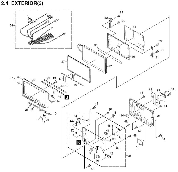

When buying parts, be warned - the screen is actually many parts (see attachments below) so what you get might depend on how deep your scratch is.
27 - Touch panel - CSX1093 - $50.09
47 - LCD module - CWX3263 - $275.74
