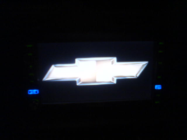

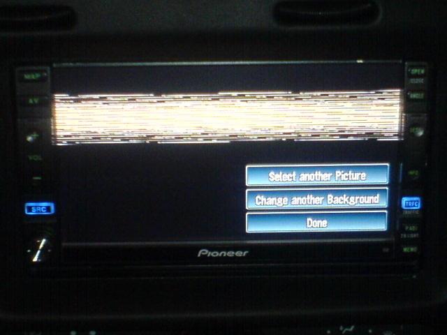

OK, just wrapped up my install of a D1 in my Monte Carlo and burned my own disc similar to the one I made for my N1. However, when I go to load my bowtie pic for a background, you can see it's nothing but a jumbled mess (it should be the same pic as my boot screen). The bowtie was a jpg coverted to pim using the PIMMGR program found here. Any thoughts? Both pics are the same size (500x240), and the background was placed in the /BG/PIM2DIN/ folder.

Well, I dug into this a little further myself, and found out it appears to have been due to the PIMMGR doing the jpg conversion. I used PimView the next time around and what do you know, the image came out fine.
