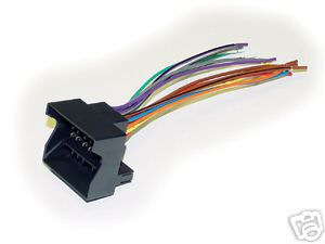

ive done anything like this before but i want to try to do it on my own. i already have a system installed (amps connected to speakers and sub)
how do i know which wire goes with which is there a wiring diagram or a harness that i can use?

buy a aftermarket audi radio adapter harness from any autoparts store or you can go to bestbuy, target... etc. just connect the wires that are the same color or color/striped coming from the stock car harness with the pioneer harness. use can use electrical tape to secure the wires together or use a wire connector. heres the instruction manual from pioneers website to help you on your journey http://www.pioneerelectronics.com/pio/p ... al0221.pdf . the pic at the bottom of my post is the afterfaket radio harness which makes the world of radio installs a better place. when you buy the harness, make sure it says the year of your audi on the packaging. good luck!
