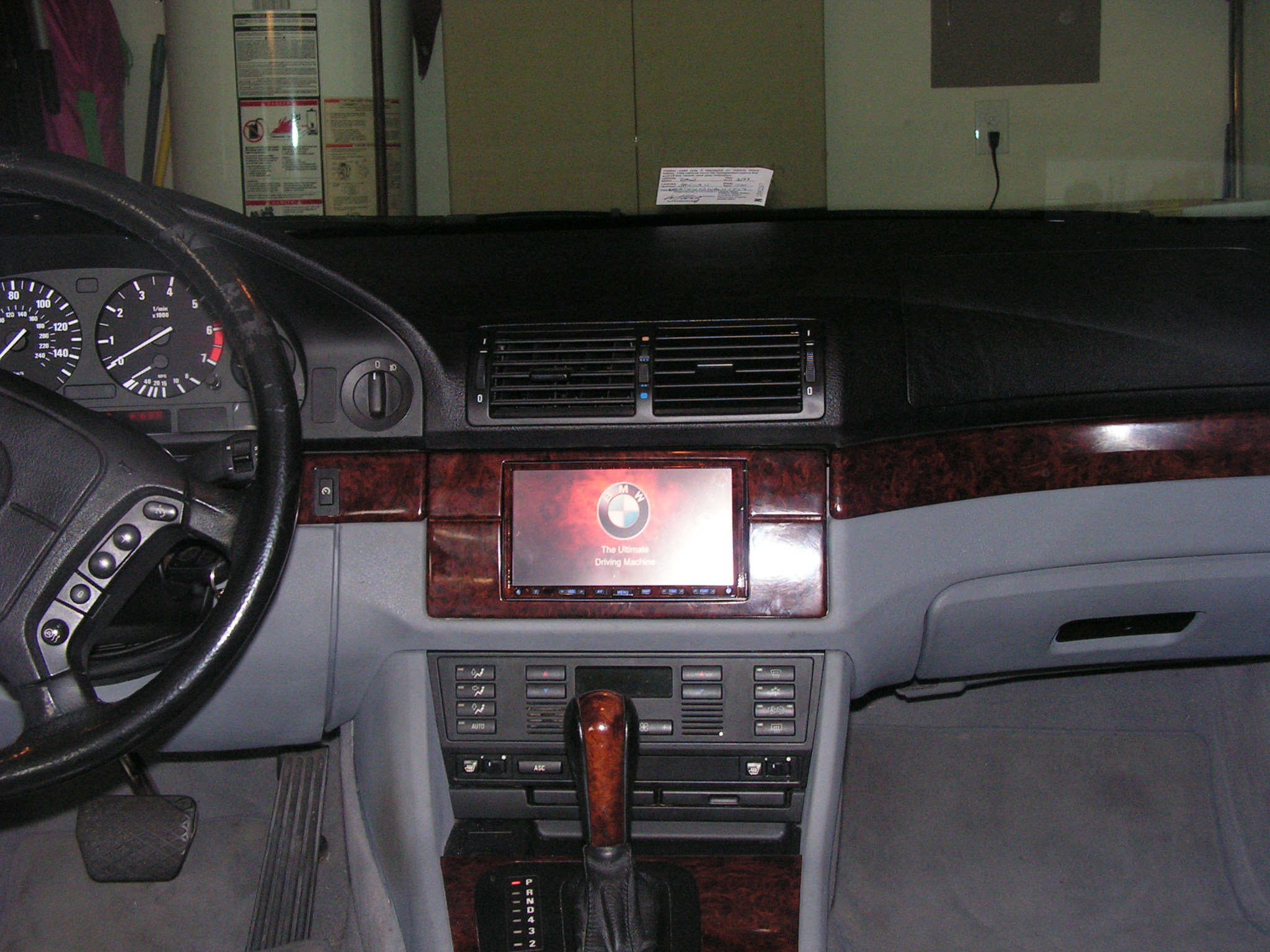

Some say installing an AVIC Z2 in a BMW (E39) can't be done or it's too hard to do. I am here to dispel the myths and show off my install. I made the faceplate from ABS & a srtip of wood. I hand crafted the ABS with a hack saw and file. I cut the wood out of a simple pine strip. The tricky part was matching the color. I did a web search and found a company that could color match the wood grain with the dipping process. He did an outstanding job. Lastly, I had a local installer install the radio. He did not have to do major air duct modifications or rework the internal organs. His remarks were, it was an easy install just like others. The only real drawback is that the OBC function is only on the dash now. I only can display Range & MPG. The other functions of the OBC, including time, were lost with the removale of the MID headunit. Oh well, I did not use the other stuff anyway!!!! I also installed the Ipod adapter, XM radio & Bluetooth. I did not do the bypass. Next mod is to complete bypass and add two AUX plugs for just in case stuff. All in All, it looks good as and as close to or better than OEM cause this baby has all the bells and whistles... What do you think?
Check out the "slamming" BMW background I created for the Radio & Map function. I also made a slamming OEM splash screen to boot.
BTW, I made two extra faceplates for sale and have the pattern for others to use!!!!

Is it hard? I thought you can get double din bezel kits from Bimmerman.
Either the m3forum.com or Bimmerfest.com
I've seen several 3 series and M3's with the Avic Z1/Z2

That is the nicest e39 install i have seen.I have a e39 with a d2 installed.I am interested in buying 1 of your radio kits and the info to were you got your wood piece done at..Pm me with the details plz

Many will tell you that a lot of modification needs to be done for the install. Not true. I did not do the actual radio install but I did watch the guy put the radio in. He did not have to make any modification to the air duct or inside the radio compartment. I finished the job by customizing the bezel myself from very simple components. When finished it looked (as the pictures show) like an OEM component. I only know of one guy who makes bezels (faceplates) for the BMW E39, 46, X5 or E36. He sells them (without woodgrain) for 250.00 + Shipping. I was going to buy from him but he was very unresponsive with my prepayment and never delivered the product. I had to threaten him with FTC & Internet Cops backing to get my money back. I would not recommend buying from him as others had the same experience or worse.
I had two extras dipped to match the woodgrain that I will sell. I also made several others, not dipped for sell at a reasonable price. Will explain when you contact me on the how to. I am in Hampton VA.
BTW my radio nav unit is a Pioneer AVIC Z2 with Ipod, Bluetooth & XM + Traffic.

Now that I have finished the install, I will explore all the other features like voice recognition. My steering wheel controls do work well as far as radio functions but voice recognition I have not tried yet. I willlet you know!!!
Update,
I ugraded the HDD to a Z3 60GB. I did the bypass as well. I also added a back up camera Everything works outstandingly well.......

While the E39 does not need dash modification, the E46 DOES!
I have just finished an E46 install, and it is NOT an easy task. Here is what I put in, and what I had to do, and what I started with:
What I HAD:
2005 BMW 330CI ZHP
BMW OEM Harmon Kardon GPS Mark IV (widescreen)
WHat I put IN:
AVIC Z3
IPOD adapter Kit
Bluetooth adapter Kit
What I had to DO:
1. Remove trim pieces
2. Remove passenger side A pillar cover (to route the microphone to the slot in the sunroof controls)
3. Remove Driverside kick pannel to run RCA cables to trunk
4. Remove passenger side kick pannel to mount IPOD
5. Remove center console to mount Bluetooth
6. Remove door sill trim to run RCA cables to trunk
7. Remove driver side rear seat C pillar seat post to run RCA cables
8. Remove all trunk trim peices to gain access to BMW AMP
9. Modifiy dashboard
Here is the BIG part! Modifying the dashboard required:
1. Removal of the OEM airbox
2. Removal of the interior damper arms and valves
3. Modify damper arms to angle around new radio
4. modify damper valves to not interfere with radio
5. cut a massive hole in the airbox to accomadate the new radio
Why?
On the BMW E46, the stock radio is shaped like an "L" bending around the airbox (the box that changes the air temperature in the cabin). To fit ANY Double DIN radio, you will need to modify this airbox becasue it is DIRECTLY IN THE WAY of the lower "DIN" of the radio.
I will post pictures next week.

I did the bezel & trim myself, total cost 125.00. Much personal time involved. The cost really involved the wood trim dip. I used the company APSIS USA. I provided the wood strip (home made). The speed sensor wire? It is located behind the steering column. It has been so long I can't recall the color. Sorry, I'll heck my Bentley book, good luck. Here is the link to how I completed my home made bezel/trim:

that wood trim really finished of the look. Made it look factory

I broke down and bought a Janus Design bezel. I had the entire thing color matched to my trim. I also had the trim around the face of the Z3 color matched. It is awesome. It is 100 times better looking than before. Mind you, my first cut was off the chain as well. I now have my old one that was posted on this site for sale. I also bought an extra factory style for sale...... The top was color matched like the home made one.....custom.... I need to get rid of both.....
