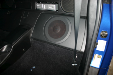

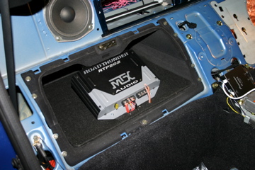

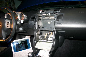

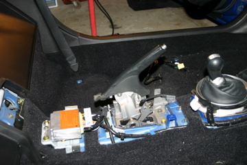

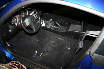

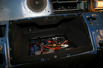

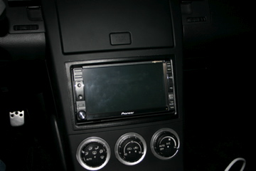

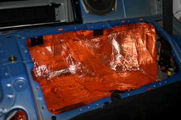

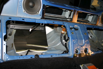

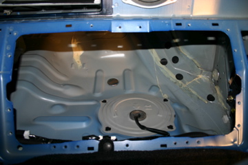

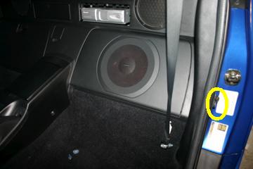

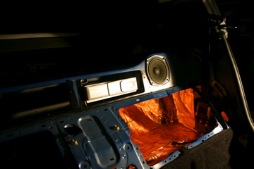

here are a few pics of all the stuff i did and the chaos that was my install..
not bad for my first navi install

You are pushing on the doorpin switch on the b pillar right? I done that more than once on a buddy's 03 z.
Posted Jan 28, 2008 · 07:23 UTC#12
ya, thats what i did..
open door.
turn key "on" (2 clicks, right before ignition?)
push button 5 times...
light should flash.. mines not flashing :(
