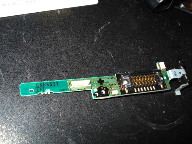

hi everybody. i accidentally broke the connector on the board. now the detachable faceplate of the n3 and the screen won't light up. i was putting on a new cable for screen to slide out and the clip broke on the board. does anybody know the part number for the board pictured? it says cnp8537 but when i look on the online part numbers, nothing comes up? can anybody help me out please because i don't want to buy another receiver just for this part. thank you! rob

I have the assembly listed as CXC4304 in the service manual.
The white connector on the board that attaches the small ribbon cable
is CKS3965
The large black connector that makes contact with the detachable faceplate is CKS4658
Bummer... the parts website shows the assembly out of stock, however the connector I think you broke is "in-stock", I hope that you can solder well...
Hope this helps... Good Luck!

cool, i just ordered it. thanks for the help CLOSEAU!
