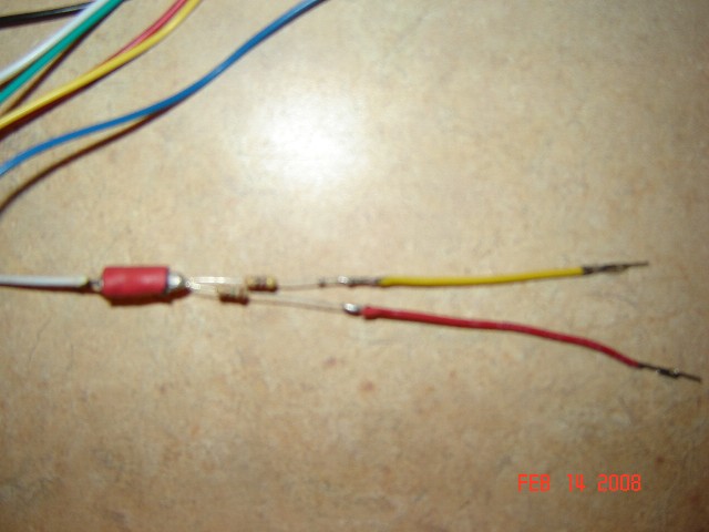

I think I got the SWI-PS worked out. I hope it works. If it might help someone else, I got into my computer parts and pulled the wires from a 3 pin connector and they seem to slide nicely into the factory harness I need to connect to. I just hope they hold. I might tape it all up also, not sure. I've attached a picture, lovely soldering ehh? I was having trouble getting the 2 resistors soldered to the one wire so I shoved them all in a butt connector with the plastic trimmed back and filled it with solder. I hope it all stays. Would anyone offer a thumbs up or down on this solution before I put it in the truck?

ok, so pc 3 pin wires were no go. It seemed they slid in and held ok but they just pop out when trying to put the deck away and screw in. So, I'll have to just tap them in. Also, I'm dying on the vss. I tried the open sorta light blue wire and no joy. I took a drive with the vehicle dynamics screen on and the speedometer on there was just bouncing around 12, 38, 122. Does thin mean right wire but bad connection or needs some calibration or is it just wrong wire? Please help. Thank You
