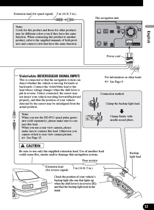

okay after installing, i have an extra wire left that is purple/white and has a black piece on it that said pioneer. is this normal or is it supposed to be connected?
Posted Feb 15, 2008 · 23:23 UTC#2
It's the reverse signal wire. IF you don't have a backup camera then you don't need it.

Did you happen to catch pg 12 in your installation manual?
