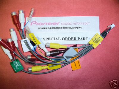

I am in the process of installing the AVIC-D3. Can someone please give me a list of which 11 wires/colors on the C2R-CHY connect to which wires on the AVIC power module? Some of the things on the avic module are clearly labeled such as Parking, Reverse, & VSS, but others are not so clear cut. For instance, the Blue/White wire on the C2R-CHY says it connects to the "radio's amplifier remote trigger output". I see NOTHING resembling this mentioned in the AVIC labels or manual. Are they referring to the Red "ACC" wire on the AVIC module???
If anyone can offer a comprehensive list of which 11 wires on c2r-chy connect to which 11 on the avic module, I'd jump for joy.

the "radio's amplifier remote trigger output" means that its the wire coming from you cars amp or your aftermarket amplifier if you have you. it should be labeled on the pioneer harness as "remote". good luck!

I'm sorry, I didn't include all info. I am using my stock Boston Acoustics amp. The pioneer has no "remote" label on any of its wires.

It should be a blue wire with a connector on the end, if I recall correctly.
It may be one of the ones that comes off of the auxillary harnesses (the one with all the RCA jacks).
That remote wire out is simply a wire that sends a 12V signal into the 12V remote input on an amplifier to tell it to turn on.

its the only blue wire on the rca harness, connect the c2r-chy to that.
