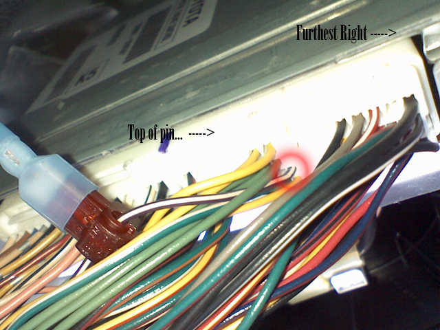

Just checking, but is this the right wire for VSS? the purple/white one that I have the T-Tap connected to? It's on the second plug from the right, furthest pinset, and 3 pins down i believe....
Posted Feb 29, 2008 · 12:56 UTC#2
For anyone wondering if that's the right pin and they're doing a corolla install, that's definitely it :D... I drove around with the multimeter on frequency and it went up and down as it should, no problems.... Now one more question... I got the bluetooth module too, does it get constant power? why isn't it switched?
