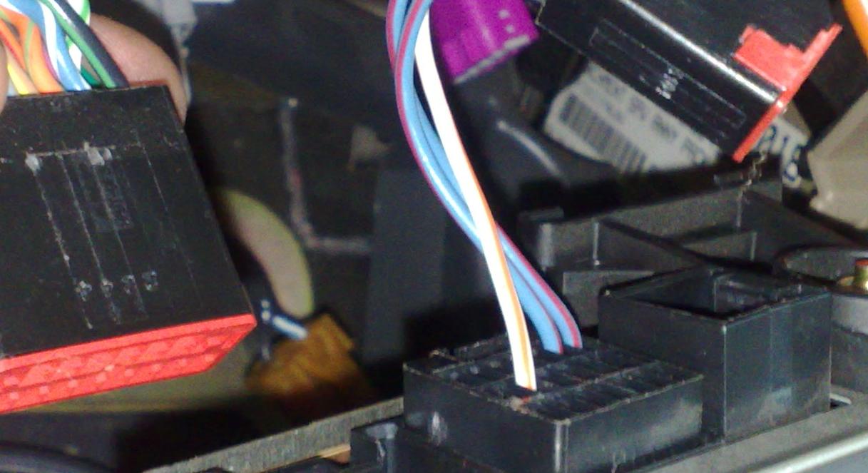

i just bought the harness and i started to take my car apart you to see it was and i noticed that my harness has 2 inputs but i have three things connecting to my mach radio. should i just ignore this third wire or what? i have a special edition mustang i dont know if it varies or not from other mustangs. i marked the addition wire with an arrow in the pic

you only need the main harness and the small mach amp plug. you dont ned to connect the plug you pointed to in the picture. just leave it unplugged. you wont have a problem.

You might have gotten lucky, it looks like the plug you are refeing to has a white/orange wire in it. If it is (as I suspect it is) then it will be your VSS wire. Tap into it there and you may not need to run a wire into the passenger kick panel.

your were close 03 gt centennial edition. here is a close up of the wire... i just activated the Speed Sensitive Volume on the stock radio, later today im going out and im am going to see if the volume changes.
Posted Apr 13, 2008 · 19:20 UTC#5
Based on the pin possition, that should be your VSS. Everytime I have seen a wire there (usually grey/black) has been on the explorer and expidition and it is the VSS. Since the Mustang uses an white/orange for VSS and you have that plug with a wire where it's supposed to be, I say BINGO!

installermarc you were right that is the ssv wire, there is no need for me to be going with all the work to go look for it at under the drivers wheel. i activated the option on my factory radio to when i speed up it would compensate the outside noise with putting the radio louder and it worked. once more thanks installermarc
