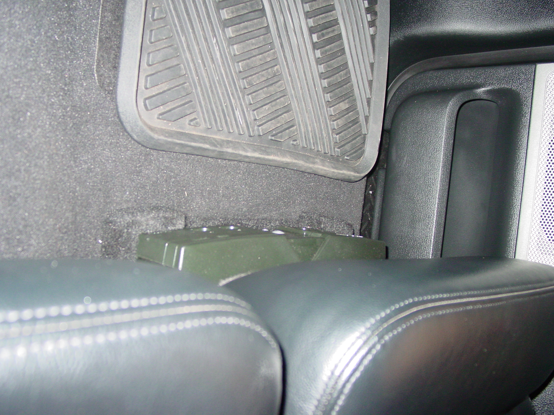

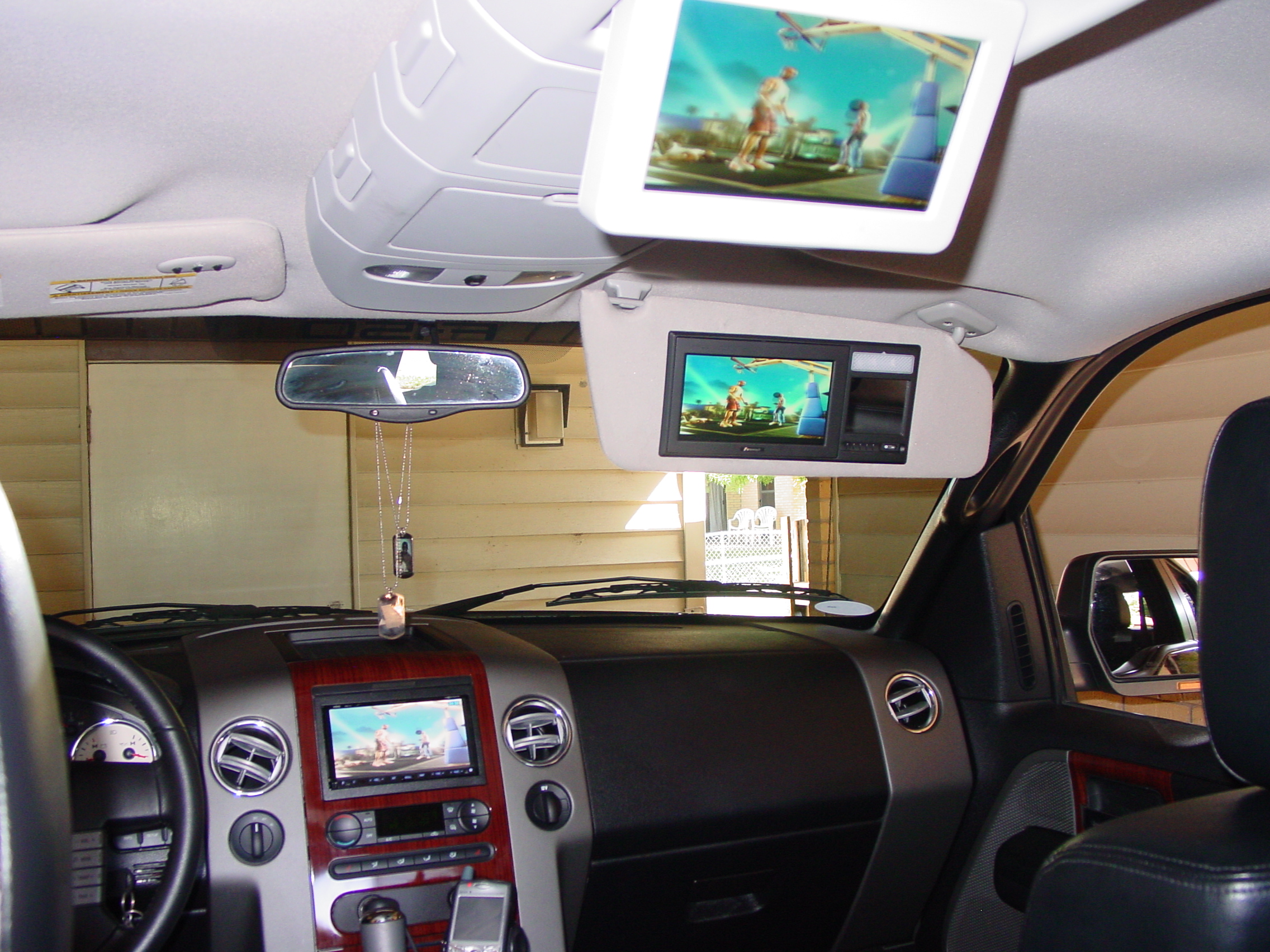

I agree with Cirbirus also about the hacked XBOX. I have one installed in my F150. I have it hooked to a DC-to-DC inverter. Also, like Cirbirus mentioned I have that connected to my battery(fuse in line). When I start the truck it is on and when I turn it off it goes off. This is good if your kids will be the one playing. In my other vehicle my son would forget and I would go to start the vehicle and the battery was dead. I did not ground my XBOX and it works great. It is not permantely attached in the vehicle. We built a small platform that the XBOX sits in. So when we get to a hotel or at home when can take it out and play it or watch movies stored on the HDD. Wal-mart sells some awesome wireless (2.4 GHZ) controllers. I got the kid's controllers in a pack of two.
Hope this information helps you. When you get it in let us see how you did.
