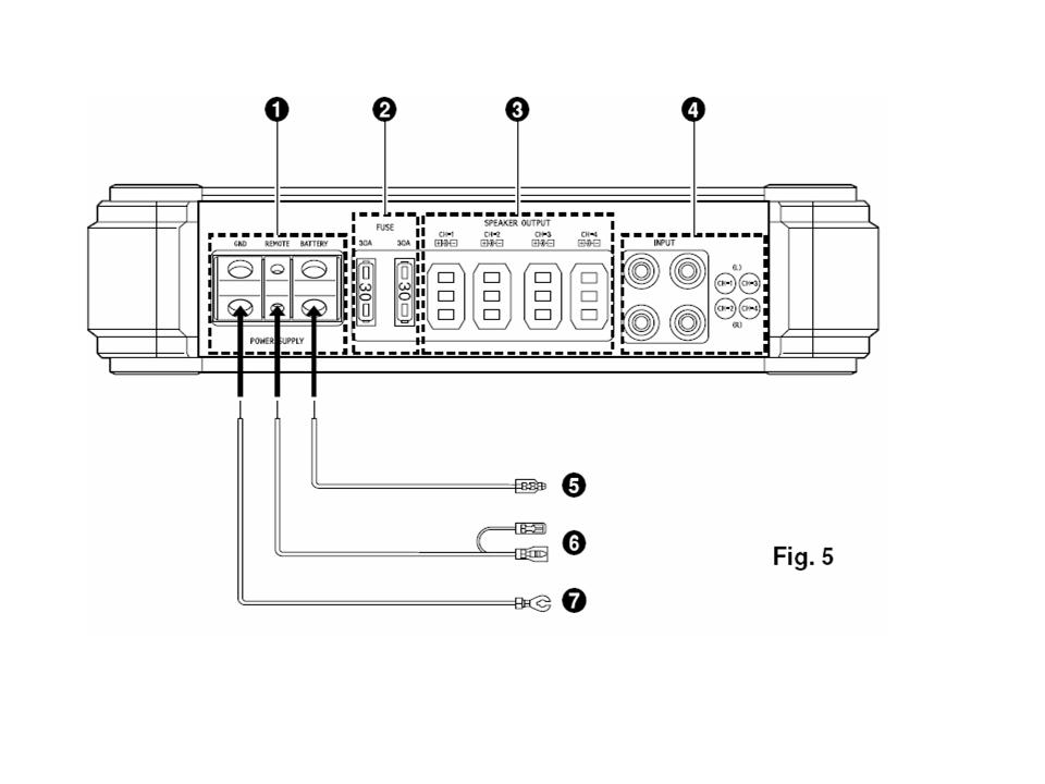

Your amp should have an input for the remote line. Most of the time, it's labeled "remote", and is near the ground and power connection to your amp. On my Alpine PDX, it's #6 in this diagram:
Posted May 01, 2008 · 20:53 UTC#8
yeah got my amp today and looked at the wiring schematic. It is labeled on there. Thanks.
