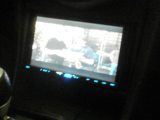

Posted Aug 13, 2006 · 19:00 UTC#5
yes, oddly enough honda had the double din kit which is weird. sorry i don't have the part number but i do have pix i took wit my fone. the shot is kinda of dark but notice how its slanted like the accords. this is a 6800dvd not a z1.
Posted Aug 14, 2006 · 06:31 UTC#6
wow thanks alot.
that does look very nice. even better how it is mounted give a lil room at the bottom.
that does look like our accord 6speed shift knob.
Posted Aug 14, 2006 · 06:53 UTC#7
good call itz an 05 accord coupe 6-speed manual. it was a nice car n the customer also bought 4 speakers, 5 channel amp, n an L5 sub. it turned out great n it looked sleek, it just sux the factory radio up top is useless.
