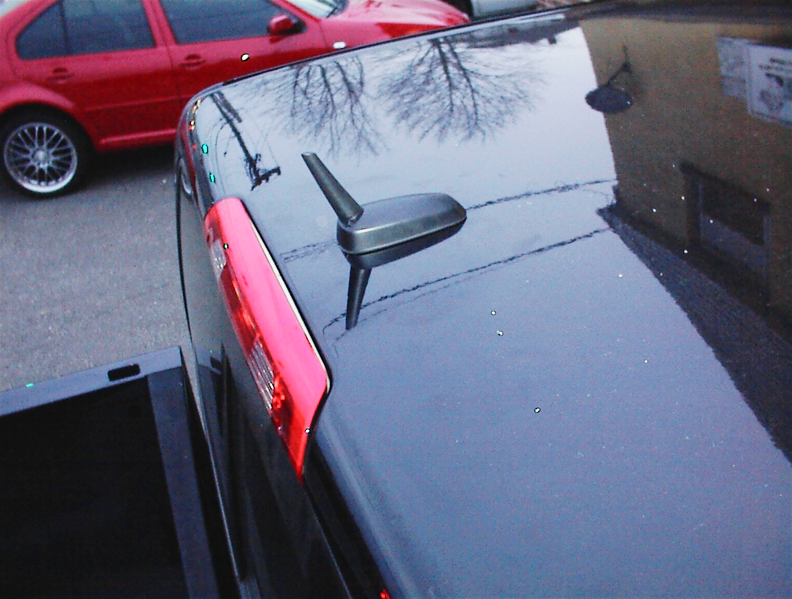

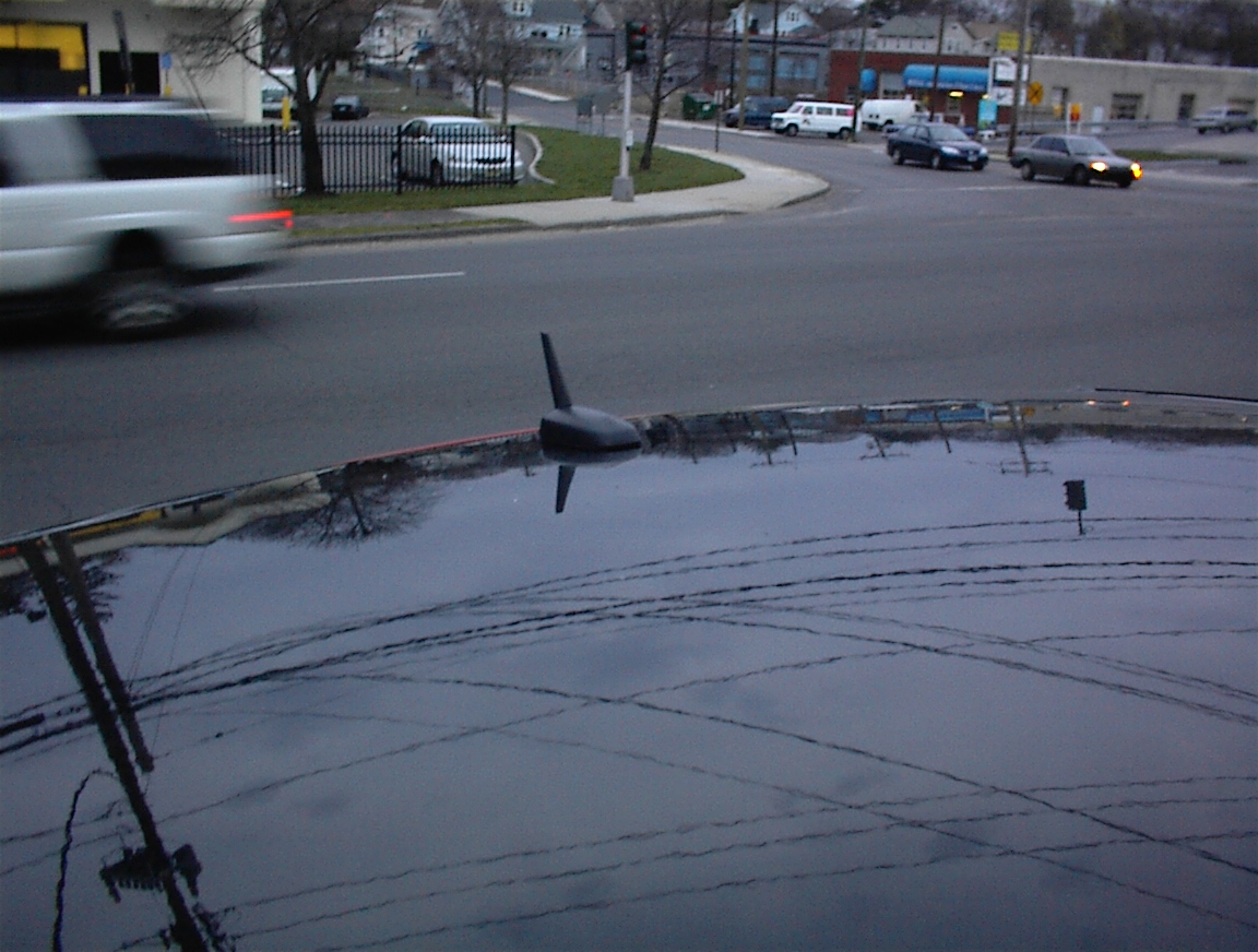

here are some pics of a GM Tri-band antenna on a Dodge Quad Cab...
[/url]
