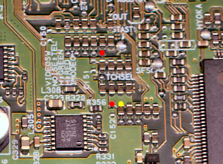

Can you clarify the SOLDER POINTS on the N1 ?
Are they the RED dots I've marked on the attached image? In your pic, there is a blob of solder on the YELLOW dot.

AMP3D doesn't seem to be around... Can anyone else help clarify the proper points to solder on the N1?
Posted Sep 25, 2006 · 11:14 UTC#6
its the red
