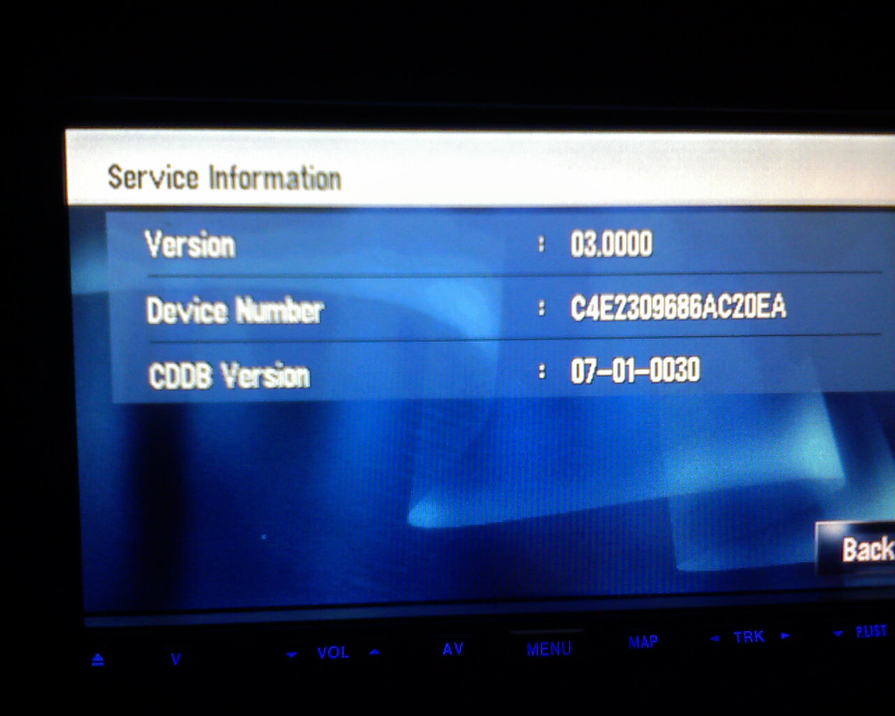

I'm wondering if anyone can verify for me that I have the new Z3 software as the person who sold me the HDD claimed. I can't find an option in the menus to look up the version, however this is a picture of the "service information" screen. This is the only thing I could find. The splash screen does indicate a cw of 2008.

That's not enough info to tell. You need to do this:
The thing to watch for is if you have the e-bay "mashup" image. Compare your version numbers to those on this list:
  • [*:m7kk8wgc]Z2:
    Version: 02.0000
    CDDB:
    Platform: 2.000500
    GPS: 1.200000
    HDD: 2.140000
    [*:m7kk8wgc]Z2/Z3 Mashup:
    VERSION: 03.0000
    CDDB: 08-01-0010 ( 2008-02-08 )
    Platform: 2.000400
    GPS: 1.200000
    HDD: 2.130000
    [*:m7kk8wgc]Z3:
    VERSION: 03.0000
    CDDB: 07-01-0030
    PLATFORM: 3.000100
    GPS: 1.200000
    HDD: 3.100200

Thank you very much. I was not aware of how to get to that screen. I have comfirmed that I do have the z3 software. I can't get into the phone menu. The manual states to hold the menu button. Does it require the nd-bt1 to even access it?
