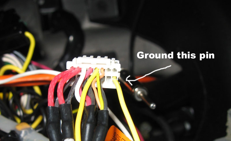

here is the way to bypass the avicz1 july2006 and guess what its free i am an installer and this information should be free on the plug in the back with the brown rca out it has 4 pins that are open no wires in them the far corner one should read 5 volts grnd this wire and the parking break wire leave it grounded reset your avic and your done i have enclosed a picture of the plug and the wire this is confirmed this works and it is how it is suppose to be bypassed hope this helps all you do is add a wire to this pin and ground with the parking brake as well

So we have to add in the RCA adaptor (for the preamps and A/V in/out) correct? Then ground the pin specified along with the parking brake correct?
Also if that is true, and the parking brake is hooked up to a switch, will flipping the switch to "float" the parking brake "break" this bypass in the event of a cop pullover for instance.
Then after that do we need to reset the unit every time that switch is flipped?
Thanks for suffering through my annoying questions.

This AVIC Z1 bypass worked great! Thanks :)
