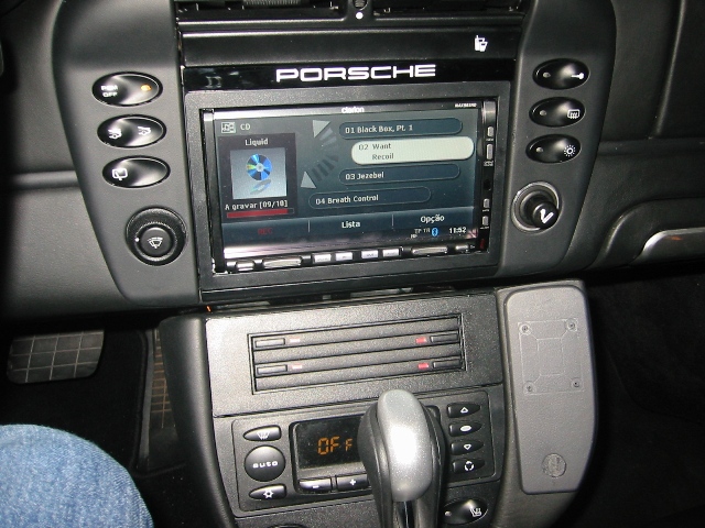

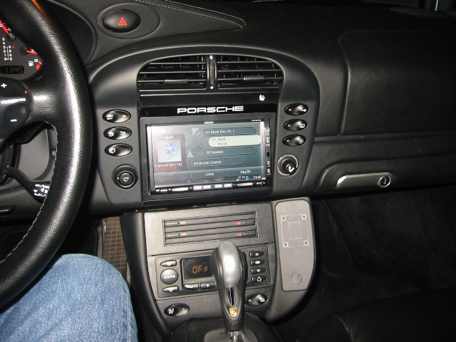

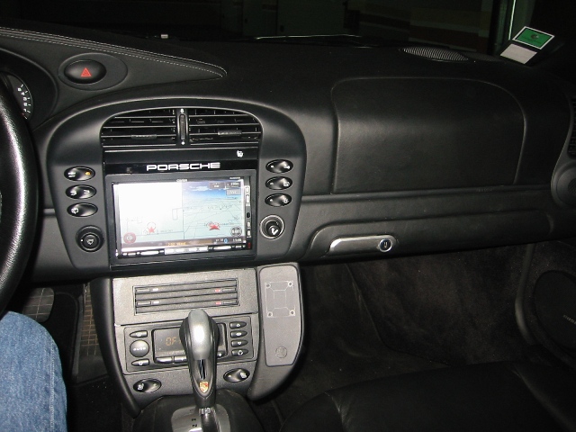

Hi all,
Just a few notes regarding my install, in case anybody wants to do a similar thing:

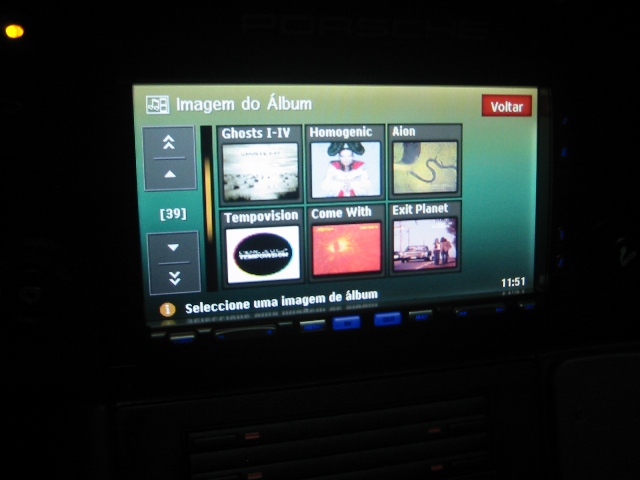

- The screen could be a tad brighter, but it is adjustable up to a 30º slope, since the screen is motorised.
- There's a hiss you can hear when playing files from the hard drive at very low volumes, although with the car in motion or the volume at normal playing levels it's not noticeable
- The principle of having a hard drive instead of an USB interface has its disadvantages but also advantages. And it holds 500 albums!
