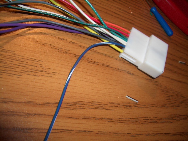

Hi,
The only wire left on my metra harness is the blue/white one, which is supposedly the 'Amp Ground' wire. The Power Antenna wire is supposed to be solid Blue (based on the legend provided by Metra at the back of the package), and I do not have a solid blue wire on the metra wire harness at all.
I do though have the vehicle antenna adapter cable as seen below. One end plugs directly into the system, but i am confused as to where to connect the blue wire that is right beside it. My guess is to attach it to the wire harness provided by AVIC that is labelled Antenna Control as seen below.
PLEASE HELP!!!

You need to connect the blue antenna wire you have coming out of the Pioneer harness to the blue antenna wire you have coming out of your antenna adapter. Leave the blue/white wire coming out of your Metra harness hangin', as you're bypassing that by performing the above connection.
