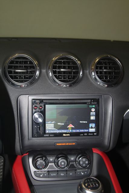

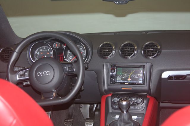

F90BT installed in 2008 Audi TT Mk2

Posted Aug 12, 2008 · 04:08 UTC#1

That looks very nice!

No, don't have the night pic yet but IMO it look great. the button red does match audi red. Install was a ratnest to say the least. The microphone is at the location where the bluetooth mic suppose to be and it work great

Original car Head unit was SymphonyII+ without BOSE
The steering wheel control work with volumn up and down, track/station up and down and mode change (which between DVD/Ipod/AM/FM) -> I use CTSA002 make by connects2 from UK. The unit does CAN bus conversion for steering control, speed signal, illuminnation, reverse.
No active antenna adapter, I just use adapter from Euro-part.us for FM. I receive both AM and FM so i think it work ok.
Face plate was made my Connects2 in UK.
I use stock speaker AND Amp. 08TT use car amp for all speaker in the car and not just rear speaker. Essentially it is just like BOSE with less speaker
No, you do not need to by pass BOSE module. The headunit have wire to turn on external amp and I just hook that up the line to turn on Amp.
See above. CTSA002 by connects2
No need for removing alarm code for radio
