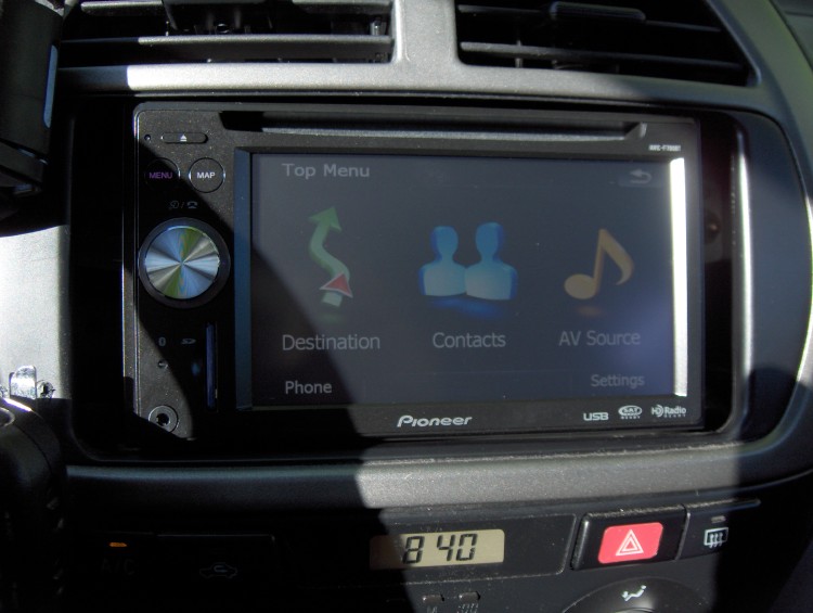

I have a question regarding the dash trim... the Toyota radio had an oversized faceplate so there are gaps to either side of the Pioneer. The top and bottom are fairly close though. Can anyone direct me to where I could get some trim or something to fill those in? I've seen radio dash trim kits for the Rav but they are all geared for single-DIN radios, nothing for double-DIN.

you can go on ebay and get a universal double din trim ring, you basically cut off the excess that you dont needand it covers the gaps very nicely. also ive seenthem at walmart best buy and circuit city. local audio shops should have it too

hi, you need those plates from http://scosche.com/products/productID/169
you see here an old picture of my rav4 to show you those side plates i bought in the states for a couple $.

Thanks for the info! I've got a set of the trim side panels on order, hopefully they won't take too long. In the meantime I went ahead with changing out the white connector so it only has the bypass and the line-in connections, sure clears up a lot of space behind the unit. I ran the USB cable into the glovebox and the line-in connections to a storage area under the dash. I also remembered to connect the antenna line this time!

Thanks again for the info! Crutchfields got me the trim parts next-day, and I reinstalled it all this morning. The side trim bits aren't 100% perfect, but it's a heck of a lot better than the empty gaps from before.
