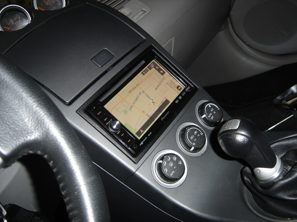

Well I bought the Metra 99-7402 install kit and the PAC ROEM-NIS2 to wire it up. The install went really smoothly. The install kit fits perfectly and centers the deck well in the dash.
The line leveler from PAC also works fantastically. The stereo has amazing volume and the sound compared to the oem stereo is so much better. I really can't express how bad the stock sound is compared to simply adding an aftermarket head unit.
The wires in the PAC ROEM-NIS2 are exactly the same as the wiring harness from the radio so you literally just match them up. I did the bypass as well while I was at it so I can program the nav and watch a DVD while driving the car.
All in all, it was 2 hour job from start to finish for the install. It took me about 45 mins to make up the harness including soldering. THe PAC ROEM-NIS2 only had 4 wires not used. They were low level inputs for radios with less than 25W so these don't apply to the AVIC D3 obviously.
Really anybody putting an AVIC D3 into a 350z needs the install kit and that PAC unit, it made the install a breeze.
Posted Aug 26, 2008 · 14:35 UTC#6
very nice and clean
Posted Aug 26, 2008 · 18:16 UTC#7
I installed mine yesteday, have a few problems though, my 03 cubby wont go back all the way, and i need to notch my console so my antenna wire will be ok.
