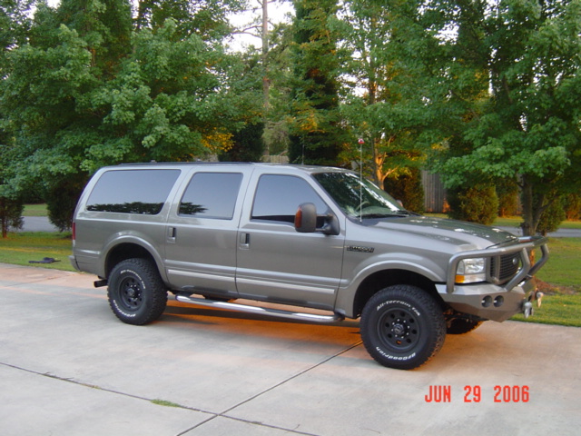

ps here is a pick of my truck..install pics to follow..

I like the push bar and the bumper. Looks pretty cool.

Have an 01 Excursion, where did you get the bumper? Very nice.
