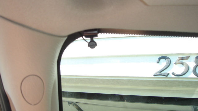

Posted Sep 23, 2008 · 19:43 UTC#9
I found that this was the best placement for the mic
