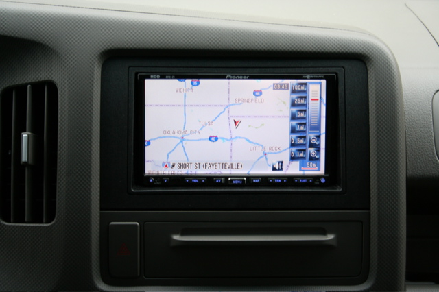

Anyone know where a easy to get to wire would be in a 2006 Honda ridgeline so i could let the z1 know im in reverse?
any help thanks!!!

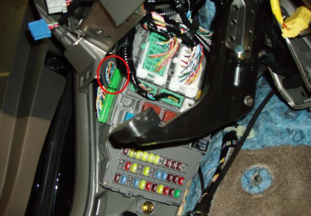

the reverse wire should be green, at the MICU (Multiplex Integrated Control Unit) should be part of the underdash fusebox. it should read 12v wen in reverse gear, test wit a multimeter. good luck man.
Posted Sep 05, 2006 · 11:29 UTC#3
I found this from another forum. The connector with the green wire is circled in the picture. Test with a meter.

Thanks for that info! im going to try that this weekend.. or if i can get to it sooner! i will report back and confirm.. im also working on a doc for this install... full of pics and what i did.. I also added 2 9" screens in my headrests connected to this unit! Im in love... i recieved a July 06 unit so the hack was WAY too simple!!! thanks for this site.. its awesome.. now if i can just put my computer tech skills to getting the nerve to take the HD out and start working @ it to see if i can figure anything out that no one else has.. i just cant get the guts to pull it out yet! Maybe soon!!!
