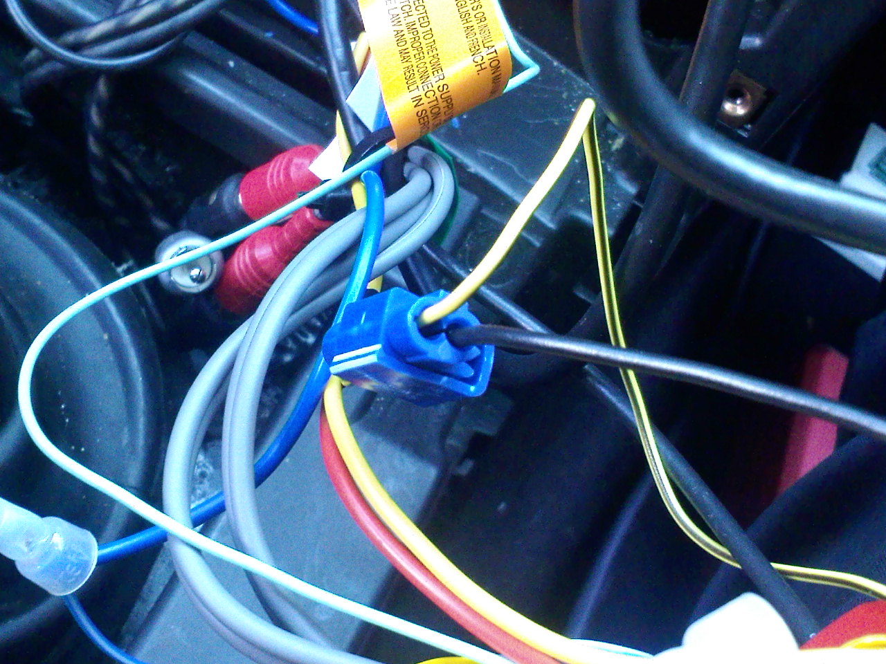

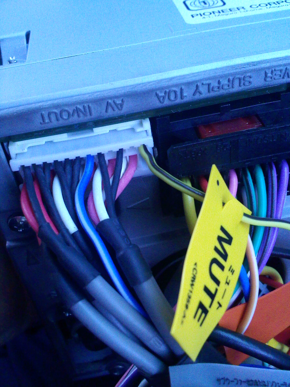

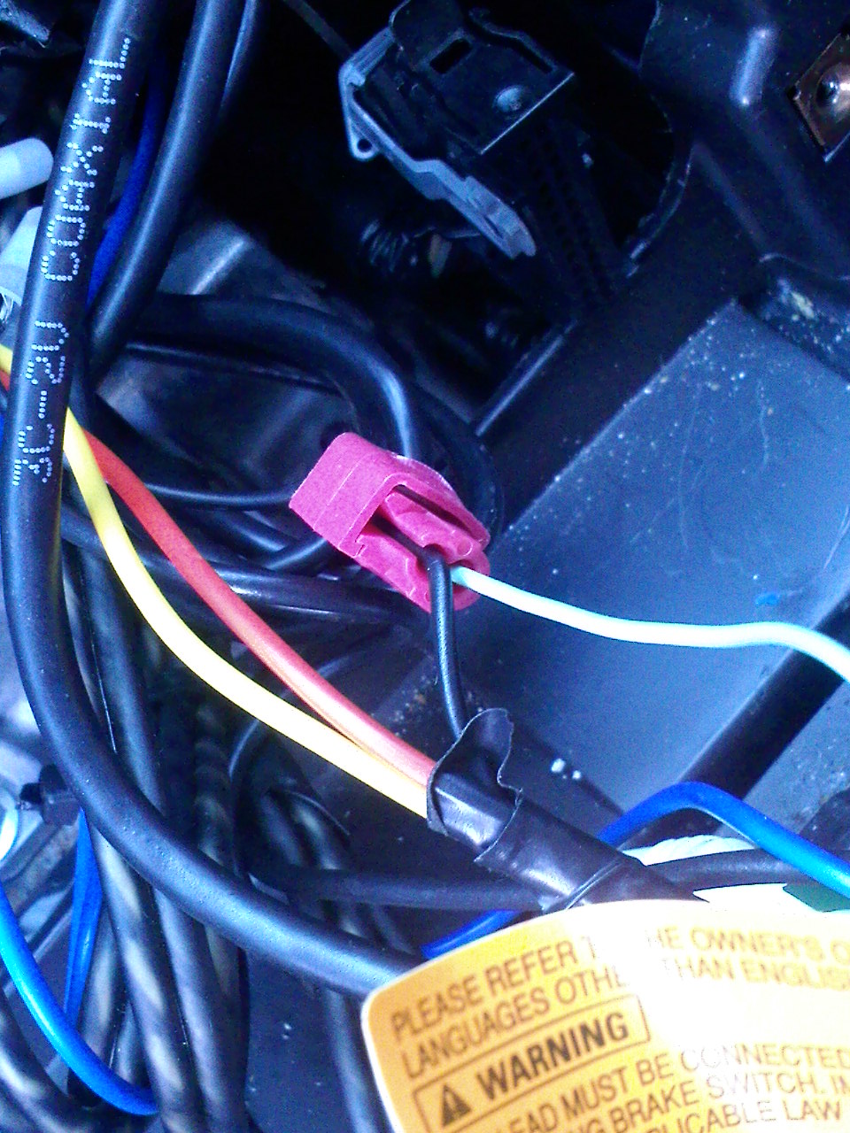

Here is exactly what I did. Could it be that my unit is a refurbished unit from Pioneer and not new out of the box?

I also noticed that when I pulled the back of the HU out, the MUTE wire wasn't connected to any thing. I was just sitting there. After moving the pin and grounding it, it should be a complete circute right?
Posted Sep 18, 2008 · 22:02 UTC#7
Yes. BTW those tap-in connectors are crap... Sometimes they don't pierce the wire all the way and don't make a good connection. I usually tie each wire into a good chassis bolt or screw to make sure the ground is good.
Posted Sep 18, 2008 · 23:02 UTC#8
Do yourself a favor and buy a soldiering gun/iron
In case you havent soldiered before... (Do this in your house at the dinner table with something under you to protect the table so you dont piss off your woman/mom whatever the case may be)
Strip back just enough of the insulation on the wire youre tapping into that you can wrap/twist the other wire around it. Don't cut the wire, leave it intact just push back the insulation. Use a razor blade to cut the insulation. It makes a clean cut in the insulation and it wont accidently cut the wire. Put the soldiering iron/gun against the twisted together wires and with your 3rd hand (LMAO) push the soldier into the wire (not against the soldiering iron) if it doesnt start to melt after a few seconds just wait a little bit til its hotter and try again. With electronics you have to worry about too much heat going into the components but when youre just soldiering wire you dont really have to worry. Just dont melt the insulation on the wires too much. If after a few tries you cant get the soldier to melt and the wire is feeling really hot you can touch the soldier on the iron just a bit to get it started but as soon as it starts to melt move it over and push it into the wire and dont let it pool on the iron tip. Its not very hard and it'll make a much better/reliable connection. You can pick up a soldiering iron at radio shack or whatever pretty cheap. You can also get some heat shrink tubing there to put on the wires after you soldier them. If you dont want to mess with the shink tube then just use electric tape.
Those connectors you have there work (sometimes) but they are absolutely crap. You should throw them away.
