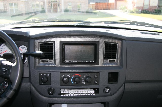

I have a 2007 Ram 2500, and I have installed the Z2. I started with the small factory dodge radio, and swaped to the nav dash. Here is a list of parts you would need to install it to look stock.
2006-2008 Dodge Navigation Dash:
(OEM part comes in many colors)
This can be bought at your local dealer or online.
https://www.dodgeparts.com/index.php/cP ... 5814c5babd
OEM part numbers for the Navigation Dash Bezel for the 2006-2008 Dodge Ram, if you prefer to go through your dealer:
1CP581DHAA Slate Gray
1CP581J8AA Khaki
5JZ121DHAC Maple & Slate Gray
5JZ121J8AC Maple & Khaki
5JZ131Z2AC Maple & Satin Silver
Install kit:
American International CD-K650 (by far the better looking)
or
Metra 99-6510. I had the Metra part and changed to the American International. Take the time to find the American International kit and you won't be disappointed.
Antenea adapter:
Metra 40-cr10
or
Scosche CRA
or
AMERICAN INTERNATIONAL CR6
Can Bus Adapter:
(provides VSS, reverse, illumination, switched power, etc wire connections from the factory harness)
Scosche DCCR03SRB
or
Peripheral Concepts CHYAH05
This would be everything you need to install a double din in a 2006-2008 Dodge Ram 1500, 2500, or 2500 without factory navigation.

If you do not have wood grain, then you will order either the grey or khacki depending on your interior color. It will have a 'carbon fiber' type pattern around the radio. It looks much better in person than in the pictures above.
