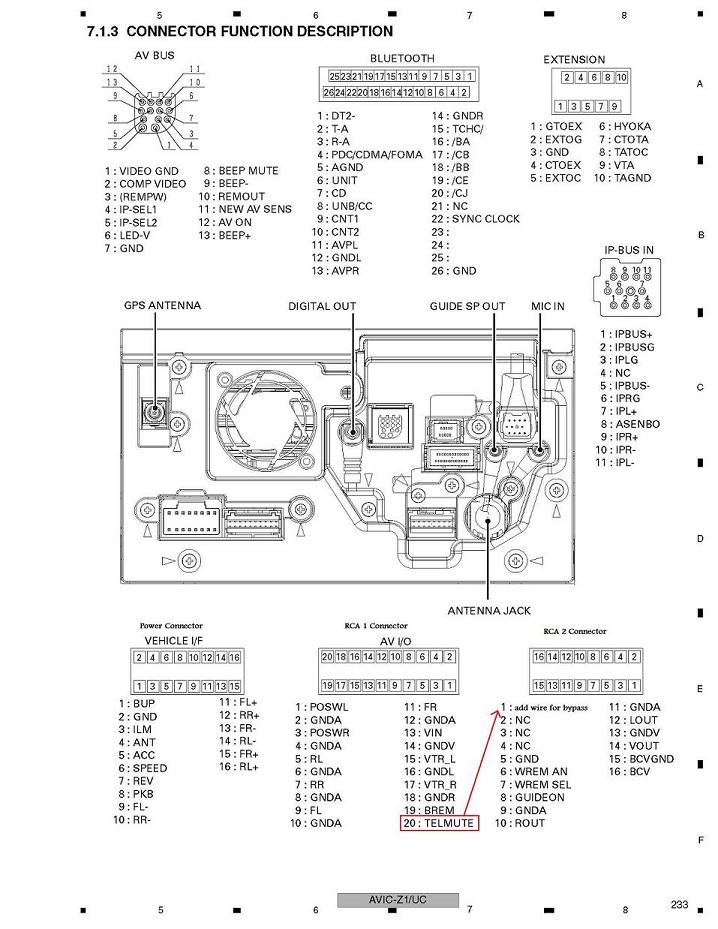

yesterday i was putting my z-1 in and i almost got it all the way back and it went dead. i figured i lost connection somewhere. checked all my connections there good. so i check all these fuses there all good. but the z-1 wont turn on. today im ganna check everything with my volt meter and make sure everything is egting power. any ideas what to keep my eyes open for while im in there? also... the blue wire, looking at the harness its the 4th wire from the right on the top. solid blue is this not the remote turn on? i could have sworn it was, i used to be the bomb at this and now im forgetting this stuff. strigthen me out!!
Posted Oct 19, 2008 · 18:51 UTC#2
Here is the pin out diagram for the back of the Z. This should help you identify the wire locations in the connectors.
Posted Oct 19, 2008 · 19:06 UTC#3
thank you very much sir... i dont wanna explain my stupid mistake.
