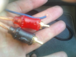

it has rcas but the cables i put in my old car looked like this....

on the back of ur d3 you should have a rca harness and in that harness is a blue and white wire to turn you amp on..if u bought it used you may not of received that harness
Posted Oct 26, 2008 · 22:25 UTC#5
You should have this harness:
Since you have only one pair of RCA's I'm going to assume system=subwoofer in the back. connect those RCA's to the Subwoofer Outputs from the unit, and connect the other side to the RCA In on the amp. Remote wire goes to the blue and white wire, and you know the rest.

one last thing. is it ok if i use those cables i posted in the picture?
Posted Oct 26, 2008 · 22:35 UTC#8
Yes those are the cables that give your amp the sound. Your sub won't play without those.

I'm guessing the previous owner did not have the AV harness installed. You will need a new AV wiring harness if you want to hook up an amplifier. LINK
