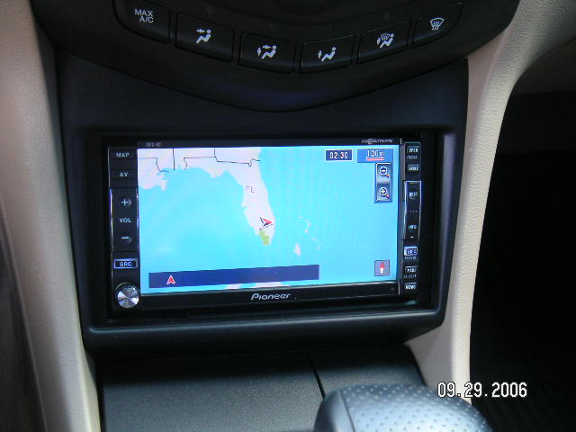

thanks for your help guys. Here is my install.

Not bad? Just out of curiousity you wouldn't happen to have the factory 6disc changer up there would you? if you do, I can help you make that work too.
