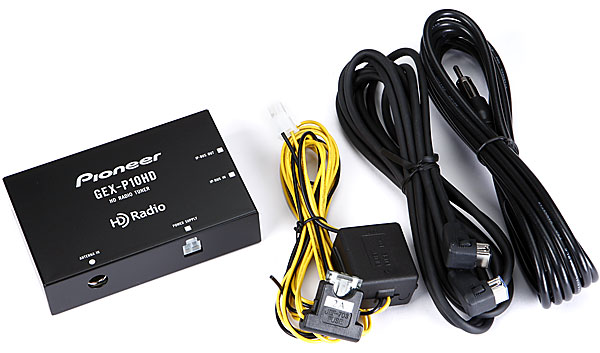

Hi, Newbie here lol. Just got my Z3 installed today on a 2006 Dodge Charger, everything went fantastic (including the bypass, which was piece of cake!). Just have a quick question, I installed the Pioneer GEX-P10HD HD Radio Add-On Tuner and I am not getting any signal/FM stations. Is this Tuner not compatible with the Z3?

This tuner is relatively a plug and play application. The installation was a breeze, including the power supply. But I am not getting any signal at all.

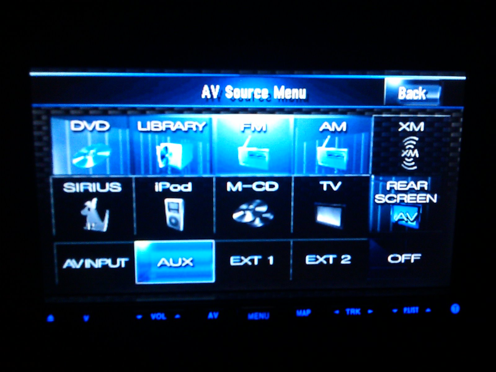

The source "EXT" is disabled. All connections are connected properly. I did read the manual before posting :D This is why I am asking if this HD tuner is compatible with the Z3 series? Look at the picture below as you can see the function EXT 1 & EXT 2 is disabled.

Double check that you are receiving power and ground at the HD box with a volt meter. Also double check that the P-bus cables are plugged in securely. Ext 1 should light up when the HD box is hooked up
