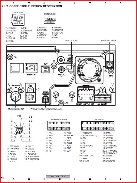

I wanted t know what color is the wiring for the vss? and what wiring bundle is it on , the speakers one or the av outs and in one?
Posted Dec 10, 2008 · 12:37 UTC#2
See if this helps. VSS should be pin 10 on PS connector.
[/img]
Posted Dec 10, 2008 · 20:24 UTC#3
its pink on the speaker harness
