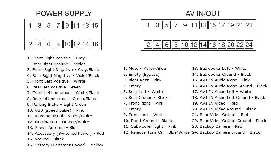

Hey guys I'm tryin to bypass the unit I bought off ebay...put there seems to be no parkin brake wire on the power harnes...there is not light green wire..seems as if its pulled out...do I have to buy another harness or can I do sumthin else??? Thanks alot

what radio do you have? You can alway look at pioneer.com for the install guide for the radio and it will tell you where the wire is suppose to go or be.

I have the avic d3
Posted Dec 19, 2008 · 03:24 UTC#4
I have the avic d3
the power wire harness i got with the d3 has no wire for braking brake....tha 1 slot is empty like it got pulled out or something....do i have to buy a new power wire harness or can i use some type of wire? thanks

here is the pinout diagram, hope this helps.

Just move one over there that your not using like the reverse wire no need to buy a new one.
