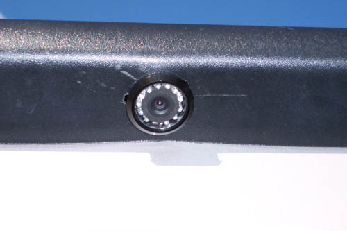

Ok i got a rear view cam on ebay. http://cgi.ebay.com/ebaymotors/Mini-Bac ... 026698997I wanted this one because it is small and gave me more options for mounting.

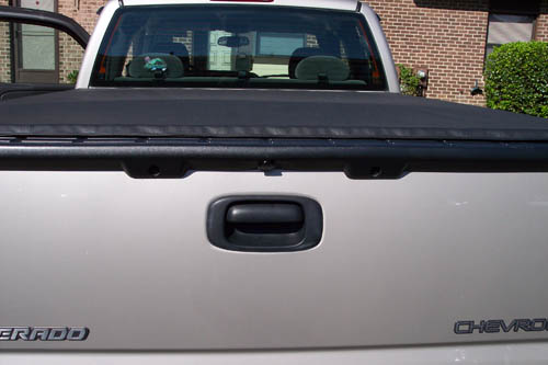

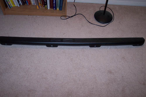

it was very easy to install. I just removed the plastic tailgate lip. drilled a hole, and inserted the camera. Oh yea and of course i wired it in too. lol
I got power from the factory tow hitch plug. It has an acc switched 12v, its the black wire if anyone is interested. If you have a gm factory tow connector you have to make sure you have the fuse under your hood installed. It comes from the factory with a blank in the spot but my fuse was taped to the harness in the glovebox.
ok thats power.
I routed my rca cord through a subframe rail right with the existing factory wiring. this was very easy and convienient.
There is a spot in most gm trucks on the floorboard where the e brake cable passes. I used this to bring my rca into the truck. its about 4 inches infront on the drivers seat and about 4 inches to the left of that. Its easy to get to, just pull the door sil, and then lift up the carpet.
ok here are the pics.

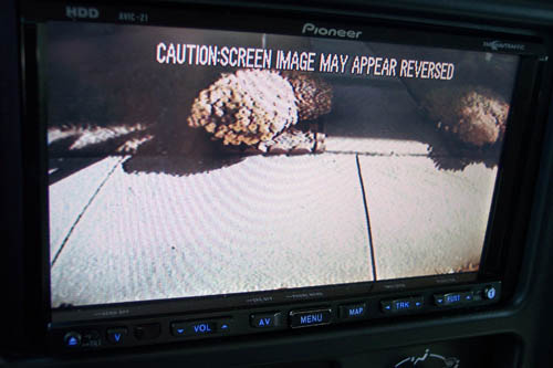

Could we possibly get a pic of what the on screen image looks like from the camera at night?

and also i will try to put up some night time shots of the screen
