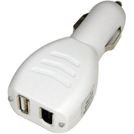

Since most of these have Y cables, do you guys think something like the following would allow our units to power a HD, given the extra amp or so of power it would spit out?

the Trancend drive works on my AVIC F90BT. I ended up buying, just in case, a usb car charger similar to the one picutred above for $20. a Scosche universal USB reVIVE car charger, model USB12v2 for the second USB plug the wire had and it not only reads the drive, but plays the music and the DIVX files from the hard drive. Seek time was instant as i only had about 20 songs and 2 movies on the drive. I am in the process of adding 50gb of music and some movies to see how it does now
