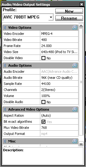

After much trial and error I was able to find a format that would playback well on the AVIC from SD or USB. Attached are the settings I used. H.264 would play but not quite as well. Xvid was very jerky.
The best option I have found yet is to bite the bullet on an ipod that supports video. The ipod does the decoding and just outputs it to the screen on the AVIC. This has several advantages:
1. the AVIC performs as fast as normal since it is just a monitor
2. Anything that plays on the ipod/iphone will play on the AVIC
3. the ipod interface is WAY better than the AVIC video interface for SD or USB.
4. you can view the map while the video continues to play in the background. With SD or USB you have to pause the video to leave that screen.
Program wise, I like to use Cucusoft (with the attached settings) for SD or USB encoding. And I like to use Handbrake for encoding to the ipod/iphone.
