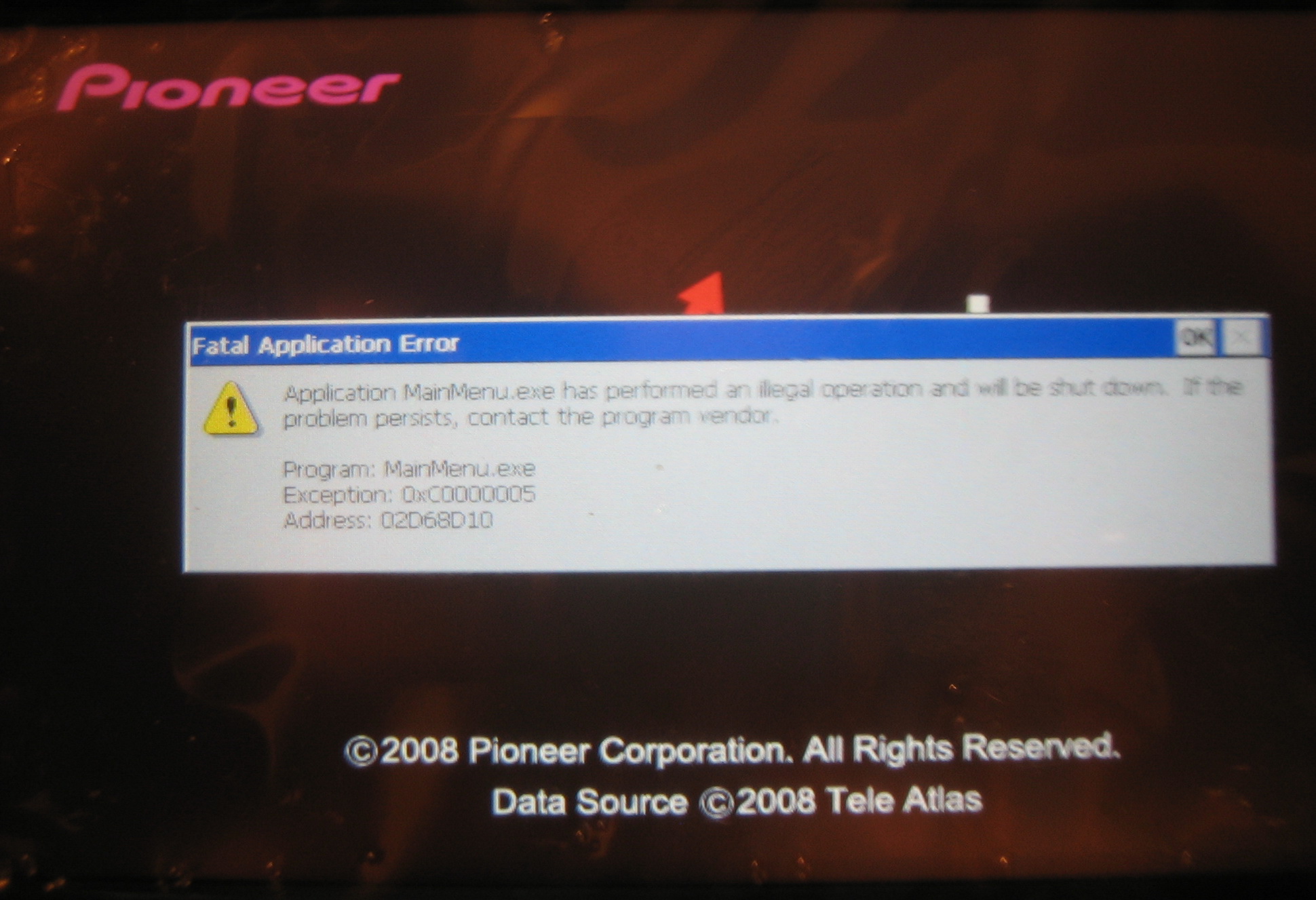

hello i have 2 units F500Bt wich i tried to add new maps.
i tried with the test mode but after entering the test mode "also i copied all the files from the flashdisk on a sd card" i put a new map on the device
after restart the device is showing me:
Application MainMenu.exe has performed illegal operation and it will be shut down
Program: MainMenu.exe
Exception:0xc000005
Address:02D68D10
is restarting over and over i tried TO PUT BACK ON THE FLASHDISK ALL THE ORIGINAL FILES SAVED BEFORE BUT IS STILL GIVES ME THIS ERROR
I UPDATED THE FIRMWARE WITH THE NEW FIRMWARE FOR EUROPEEAN VERSION WITH THE SD CARD BY THE BOOK AND IT IS STILL GIVES ME THIS ERROR
I TRIED TO PUT LeetLauncher on it it runs but when i try to access the MainMenu it gives me the same error
what should i do? i am kinda desperate!
I MANAGE TO FIX THE EUROPPEAN VERSION DAMN IT!!!
AFTER YOU USE THE TESTMODE JUST GO TO :
Flashdisk\APL2\iGo\CONTENT and delete the damn file MapDBInfo.txt
what is happening: the testmode hack is copying the MapDBInfo.txt file in to that folder and when the device reboots find that file wich is wrong and does not like it and tries to go with the files inside that DB info.txt wich are wrong!!! so just delete that file and all should work perfect!!!
