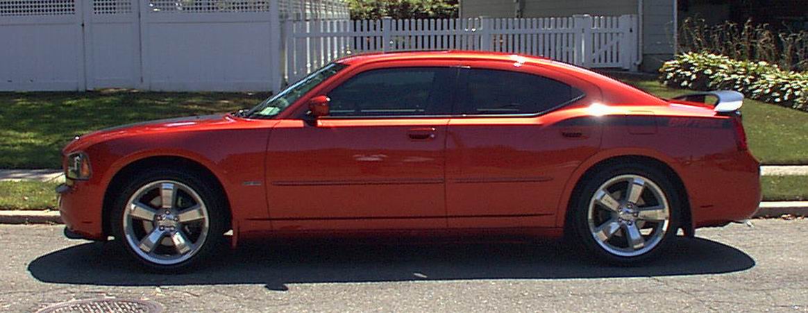

Do you know if they make an extension cable for the GPS & XM wires? I had to route them into the trunk and just barely had enough to run them under the rear seat.
Oh Yea, that was my first post, and I really appreciate ALL of your help. Here's a pic of where it's going.
