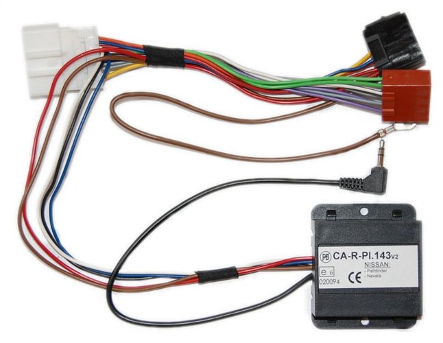

This is the Pioneer interface compatible with my car:
Posted Feb 27, 2009 · 13:25 UTC#6
the black one will fit, the brown one won't.
You could cut off the brown conenctor en re-solder the leads to the AVIC leads. (they are unconnected anyhow)
You could also check out the PAC SWI P from pacaudio(.com)
or the Pioneer adapter 192.
They both will most likely work as well.

Both the black and the brown are ISO-standard.

And the interface that I posted above is the one Pionner built for the Nissan model that I drive.
