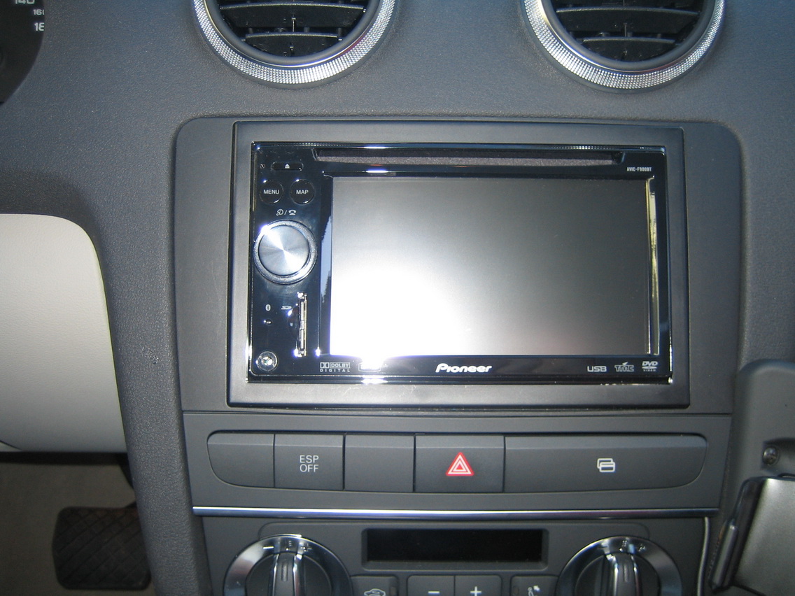

Would have been easier if you had to 2009 model as that comes standard with double DIN. But as suggested here, there kits on the market to convert to double DIN and then, i guess, it would look like this. Sorry for the flash, only had my Ixus nearby to take a pic. If you want i can make some others so you can get a better perspective.

franknl, yeah I wish I had gone for the double din radio (symphony II) that way things would be less complex. BTW I can't see the picture...

Edit>> Pic popped up after I posted! :oops: looks nice in there mate... How do you think it would look if the surround around the unit was finished in that piano black that audi uses in the doors and around the gear stick...
Thanks for that franknl, looks very slick. Nice install... Did you do it yourself? What kit did you use? What
Sorry, don't think i can help you there. Car is a contract hire car. Had the unit installed by a professional dealer who also installed the cradle for my HTC Touch HD. Actually, I do think the unit has a lot of possibilities but until now it didn't really meet my expectations. It is kind of sluggish and the bluetooth is a drama. Coming from an Avic X1 it is kind of step down. I don't know, maybe I just need to get used to it.
