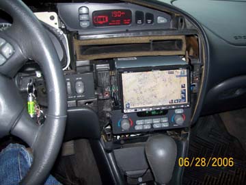

Yup,
Its possible, I have it in my 98 GPGT right now.
Lots of plastic trimming as was said.
But the distance from the top of the AC control panel, to just underneath the AC vents will fit a 2Din.

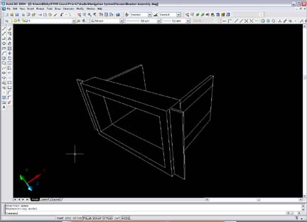

Im machining a custom bracket and will post a complete blueprint when done. Here are a few shots.

If you don't mind the extra work, I think it would look better if you lower the climate control to give the HU a little more room. Losing that bar between the radio/climate control would make it look rather odd, so I'd move the climate control down enough to keep the bar.
I had a similar problem with my 99 Silverado, so I ended up lowering the climate control and it looks pretty good. I'll take pics when I get it smoothed and finished, because IMO, it looks even better than when people take the easy way and use an 03+ bezel/bracket on the Chevy trucks.
