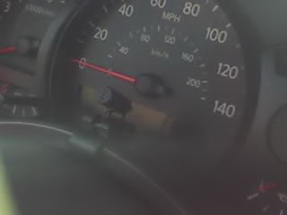

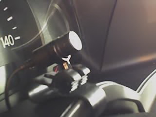

Y? When you are talking to someone tell them to help you out.Turn the phone volume down and adjust the Volume on the HU. Start from 3 turn it up 'till the other party says it's free of echo. Mine is normally phone on 3 HU on 9-11 depends on other parties phone. Also Mic placement is a key factor. Mine is located directly in front of me Behind the Steering wheel.

Used Cell cam. One is clear other dark also used Digi will post up later. Have to many on diggi need to delete. Sorry it took so long.
