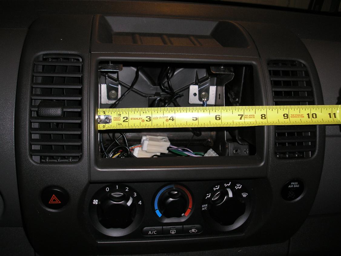

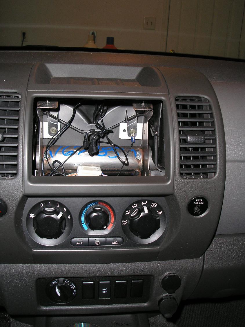

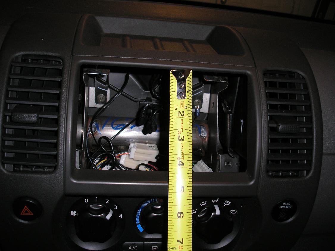

I posted an earlier post but now im in to the install part. I've posted some pics of my car without the cd player and took measurements. Im concered the d2 wont fit so id like some help from the gurus. I'm by no means a installer but it did only take me 10 minutes to remove the dash and take out my cd player....maybe i can do this after all (if it fits!!). I hope, i spent 450 dollars on the d2, im just waiting for it to arrive in the mail is why i cant check it yet....plus if it wont fit i m ight be able to get a refund before hand some im beating time here. Circuit city's website says the d2 wont fit, their road shop says it will WTF is going on here!!!
btw, where is my vss wire and my parking brake wire on the xterra, to get the most out of this thing i need to attach the vss and ground the parking brake if im researching the right.
Attached Files (4)
Posted Oct 21, 2006 · 14:47 UTC#2
The D2 will fit. I know this because I just put one in my X.
Use the brackets that are on the factory radio. Will bolt right up. Only problem is there will be about a 1/8 gap on the bottom of radio. You will understand it when you see it. All I did was use black piece of plastic and used the trim ring as a template and cut out my own ring and placed it around the radio and when you snap the front dash trim it holds it in place. Looks pretty slick, you would never notice it. So don't get a refund because it will indeed fit. I can get pics up later on today if you want. I am actually at work now installing my XM module. Got tired of the interface on Sirius.
Good luck!

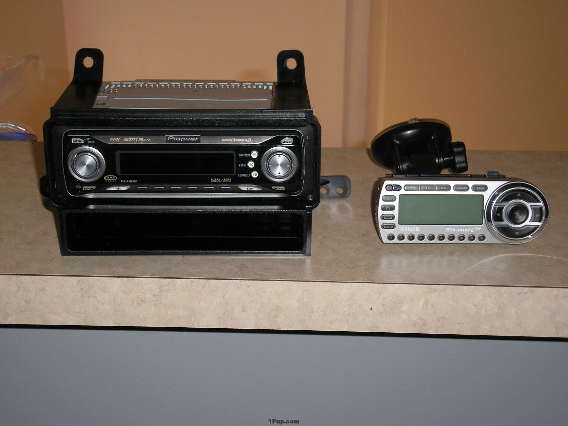

Sorry for the delay on pics but here they are:
1st: My X
2nd: The D2 with XM
3rd: The Shield playing off Ipod Video
vidoe quality is not that great because of a cheap 10 dollar cable, getting an Apple cable this week.
Any questions on pulling any panels just ask. I have taken them all off now.

mines being installed sunday. what did you use to fill in the gap on the xterra cntrylvr79?
Posted Oct 27, 2006 · 00:11 UTC#21
Had a double din trim piece from an xterra dash kit. The part number is 9-7581.
