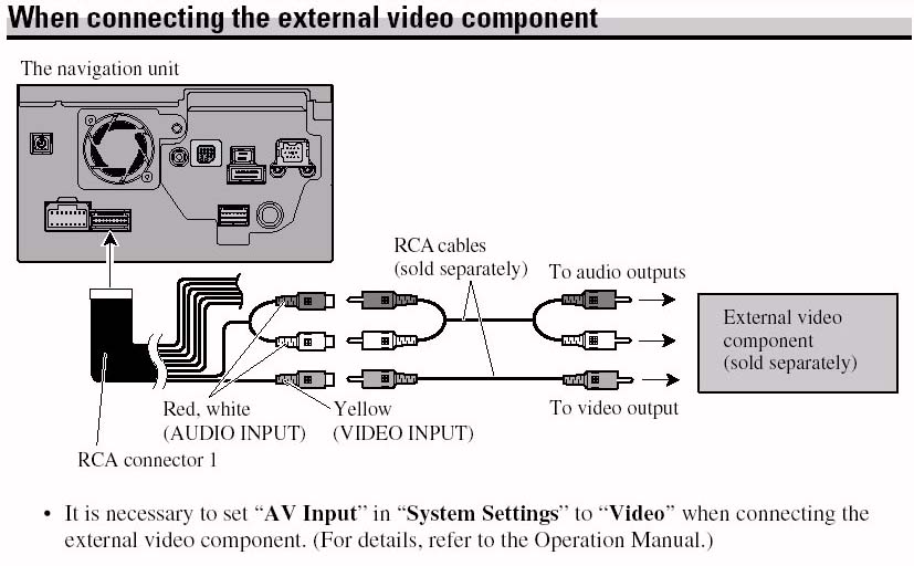

Like this using the RCA Connector 1?
The RCA cables in the pic would be the cable you said above going to the headphone jack of the iPod? THANKS!
Yes, with a video ipod, the audio and RCA video come out on the headphone jack. So you get one of those cables I posted in the links to above, and you connect the headphone jack into the ipod, and the RCA's into the AV input of Connector 1.
