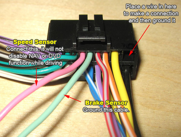

Hey people, I just installed my D2 and attempted the bypass. But when I turn on my car there is a screen that says that my brake wire is hooked up incorrectly. Can anybody tell me wut I did wrong?

Did you bypass it according to the picture below?
It sounds like you may have your parking brake wire permanently grounded without grounding the other pin.
Ground that other pin and see what happens.

Oh yeah, Thanx forgot to ground that wire that I installed!! Dumb ass me
