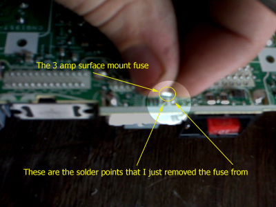

Posted Jul 12, 2009 · 20:56 UTC#3
You've fried a fuse on your circuit board that is present in I believe all Pioneer head units. This fuse grounds the shield of the RCA cables, and without it you will hear clicking, popping, etc whenever something electrical is activated in the vehicle, not to mention an irritating alternator whine at all times. I'll attach a poor quality cell phone picture of this, you can find threads on the net relating to it as well. One of those is http://forums.corvetteforum.com/audio-electronics/2305049-pioneer-avic-rca-fuse-fix-tutorial.html
