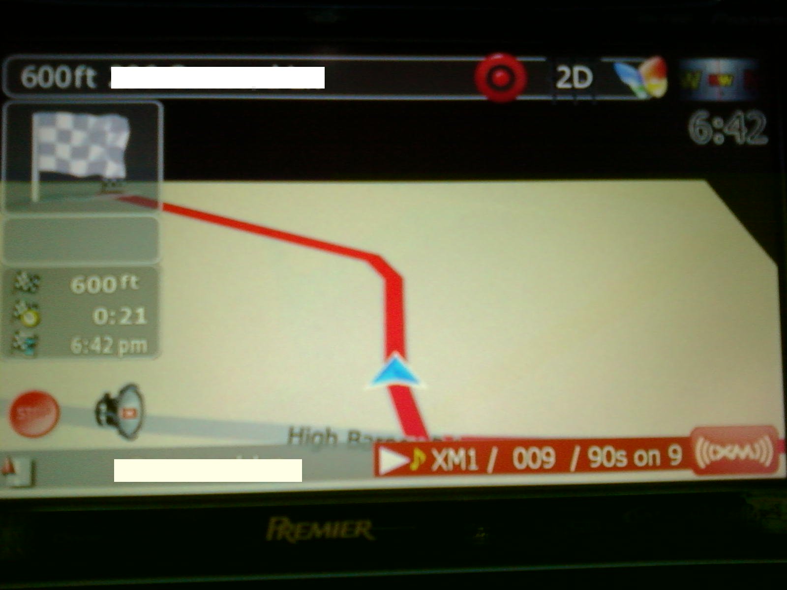

Hey guys,
I've searched this topic to death and still can't find an answer. Could someone please tell me how to edit the color of the little bar at the bottom/right of the map that contains the song name/radio frequency info? Is it a .BMP in the image.res or the data.zip or simply controlled by the color.ini in the scheme? If it's controlled my the color.ini file, which line? I've changed my schemes, ExamDiff'ed my data.zip and image.res with matt's red ones looking for his "orangey" one, etc, but to no avail. I've seen it done but can't figure this one out. Any help would be appreciated.

What you need to change are two BMP files in image.res. They are the two files right next to the two arrow icon bmp's that are also used for that bar. I just actually changed mine recently. I attached the two bmps's you need to change.
Av bmp's.zip

Thanks euro!! You rock! I spent HOURS looking for those little buggers. Much appreciated!
